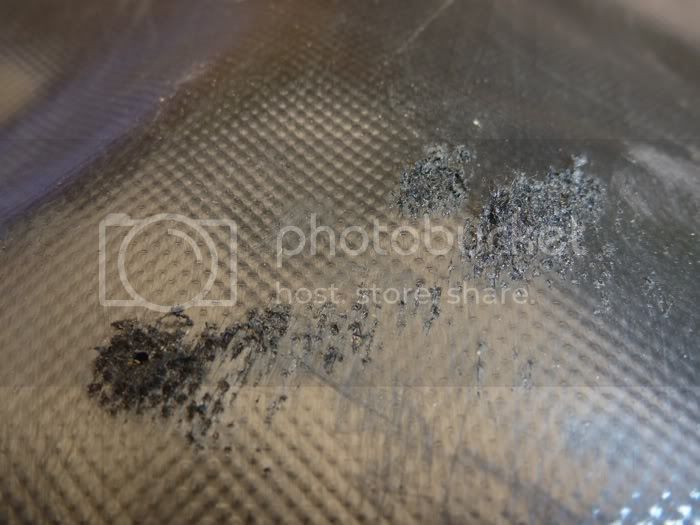

Got back from a paddle this afternoon and noticed some abrasions on the floor of my Yak.
As you can see, the spot on the left has actually torn through, creating a small hole about 2mm in diameter. These abrasions are located where the seat valve makes contact with the floor. The boat is only two months old, and has spent a total of 6 days on the water. Apart from some slight scuff marks there are no other signs of wear visible.
Curious about this, I inflated the raft and sat it in some water. Whilst sitting in the seat I ran my hand around the underside of the raft and felt that the valve was causing a defined protrusion in the floor. This would make the area of floor beneath the valve the lowest area of the boat, and hence most susceptible to wear. Additionally, on the underside of the boat the area around the valve intrusion feels harder and less likely to move when it makes contact with a rock or other obstruction. These two factors combine to form what would appear to be a weak point in the packraft’s armour!

Hi Craig.
I can only answer your first question, which is yes. I am very close to going through for the same reason. Although I have to say, I’ve hammered mine down some very bony runs and most of the underside of my Llama is showing considerable wear. I’m still amazed at how tough it is though!

Craig,
I use a foam pad to insulate my floor and the pad extends under the seat. The foam sandwiches the valve between the seat and the foam. This has prevented localized wear on my Yukon Yak.

This problem is definitely what plagues the Alpackas. Just this week I put a large patch on the bottom of my Yak, partly to make the repair I did in the field a few months back permanent, also to reinforce that area with another layer of PVC. Not only did I put a hole in the exact spot where the seat valve protrudes, I also damaged the valve to the point where the seat would not hold any air when I sat on it for more than 10 minutes. Luckily I had the patch-n-go kit to fix the hole in the raft, and detached the back rest to sit on for the rest of my trip. Post-adventure, I applied a few coatings of McNett Seam Grip around the base of the valve stem, where it meets the seat material, as that’s where the leak occurred. That fix has proven to be more or less effective, but I still notice air leaking, albeit very slowly.
